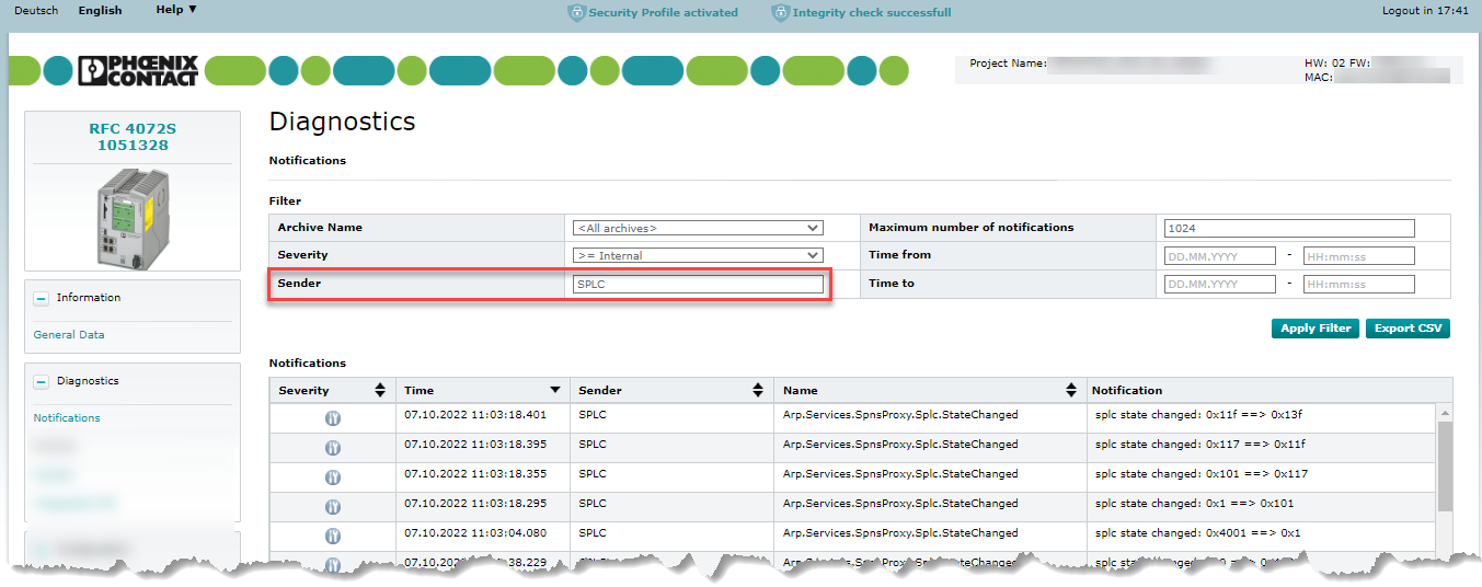

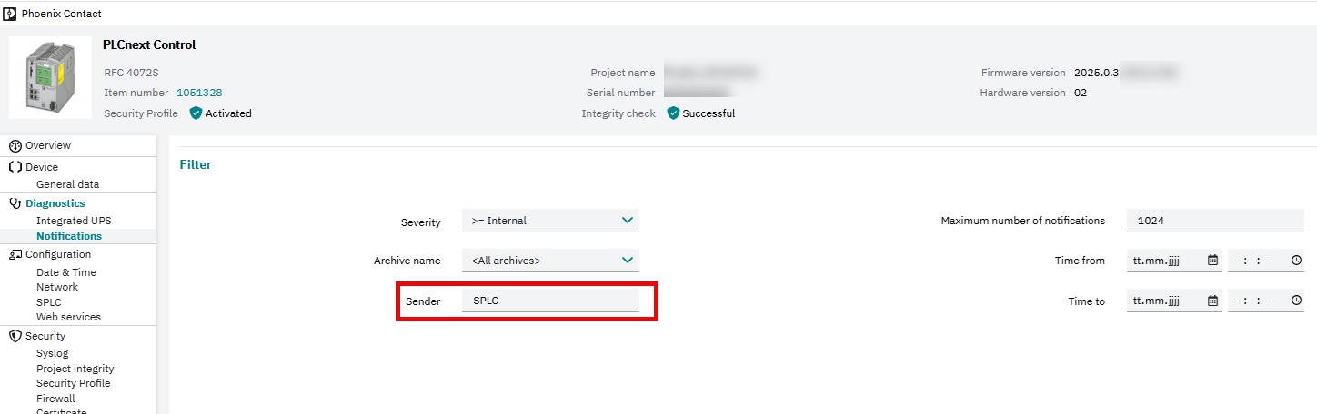

To control specific notifications when starting the safety controller, set the filter function "Sender" to "SPLC". Then you will see the corresponding notifications, example see screenshot below.

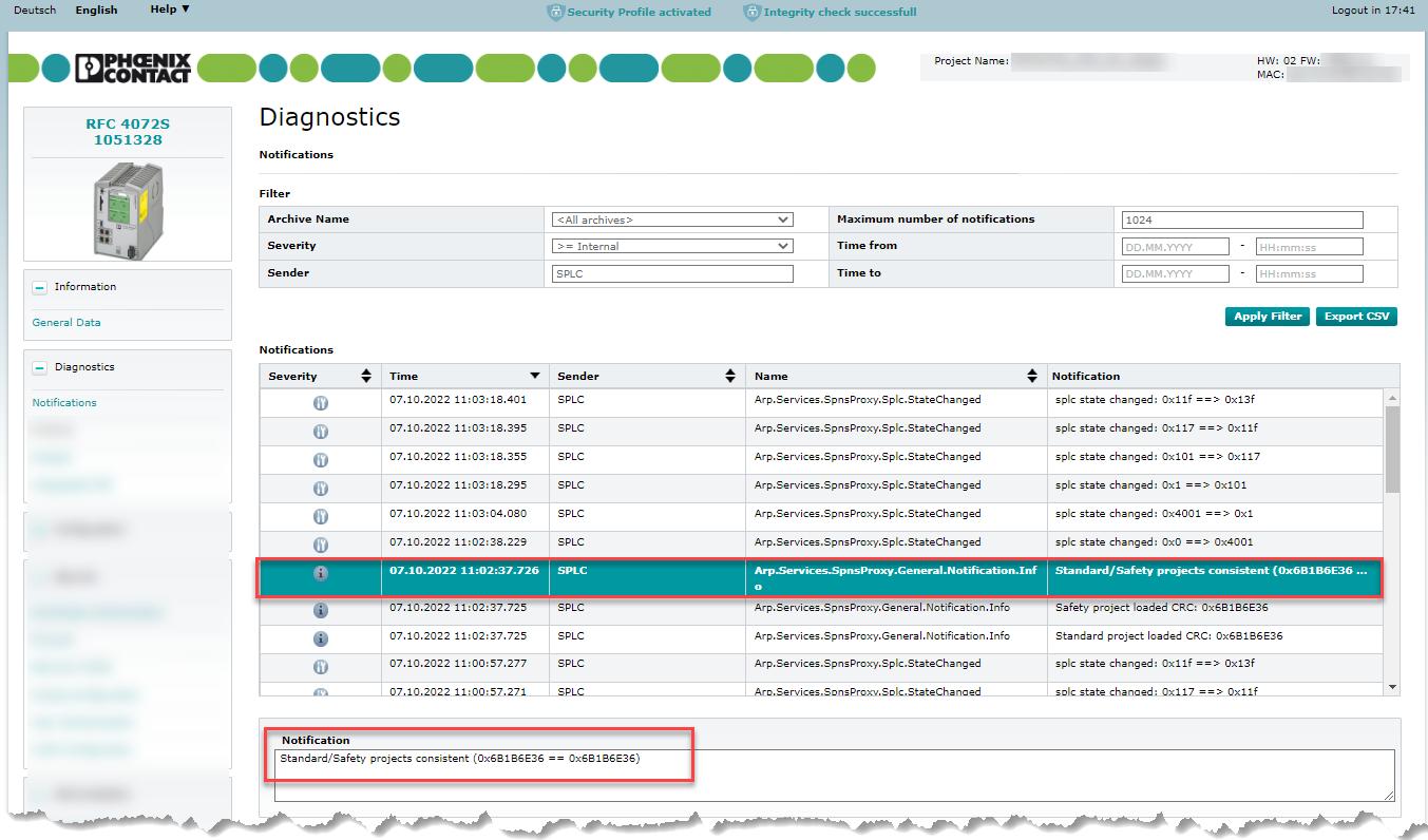

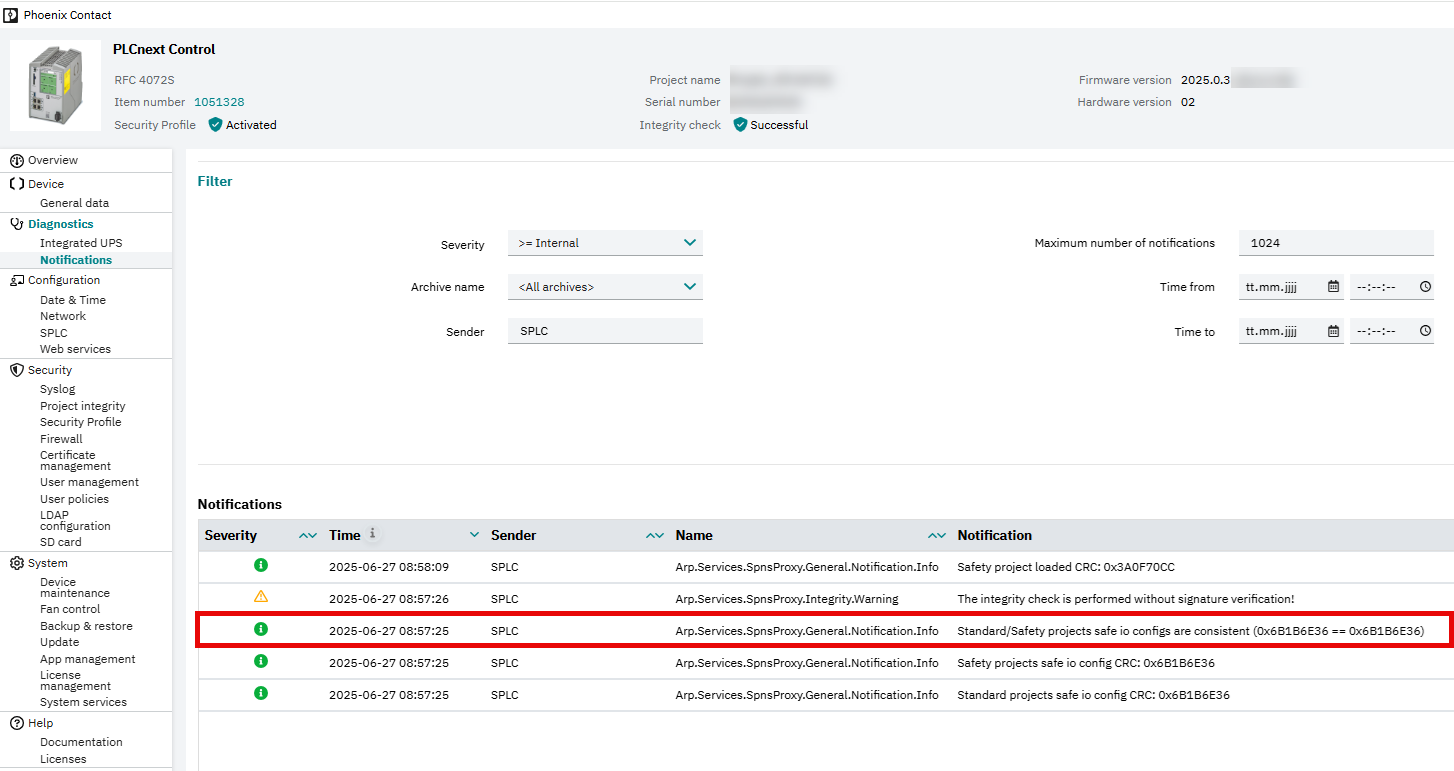

After starting the safety controller, check the consistency of the safe project and the standard project. Observe the corresponding notification for this, see the following screenshot.
The meaning of the individual error codes can be found in the respective manual (refer to the topic Product range).
